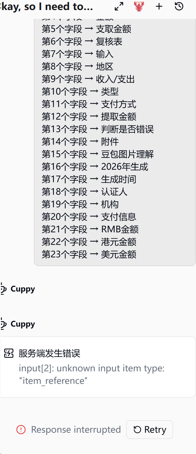

Why i cant use ai chat to edit my table
like this , dont have any response , i think it’s not the model problem cuz he have the complete thinking part , but when he want to edit the table , he jump this error , anyone can help me?

i am using ollama qwen3:8b model , Local LLM Deployment, he have the tool calling function
also i have the same problem when i start a new cuupy , i will always meet this problem everytime
Hi, following an engine upgrade on April 9, 2026, AI Chat Agent mode and App Builder now only support Anthropic-compatible API endpoints. If you’re using a custom model, please refer to our documentation for details: Custom AI Model - Teable

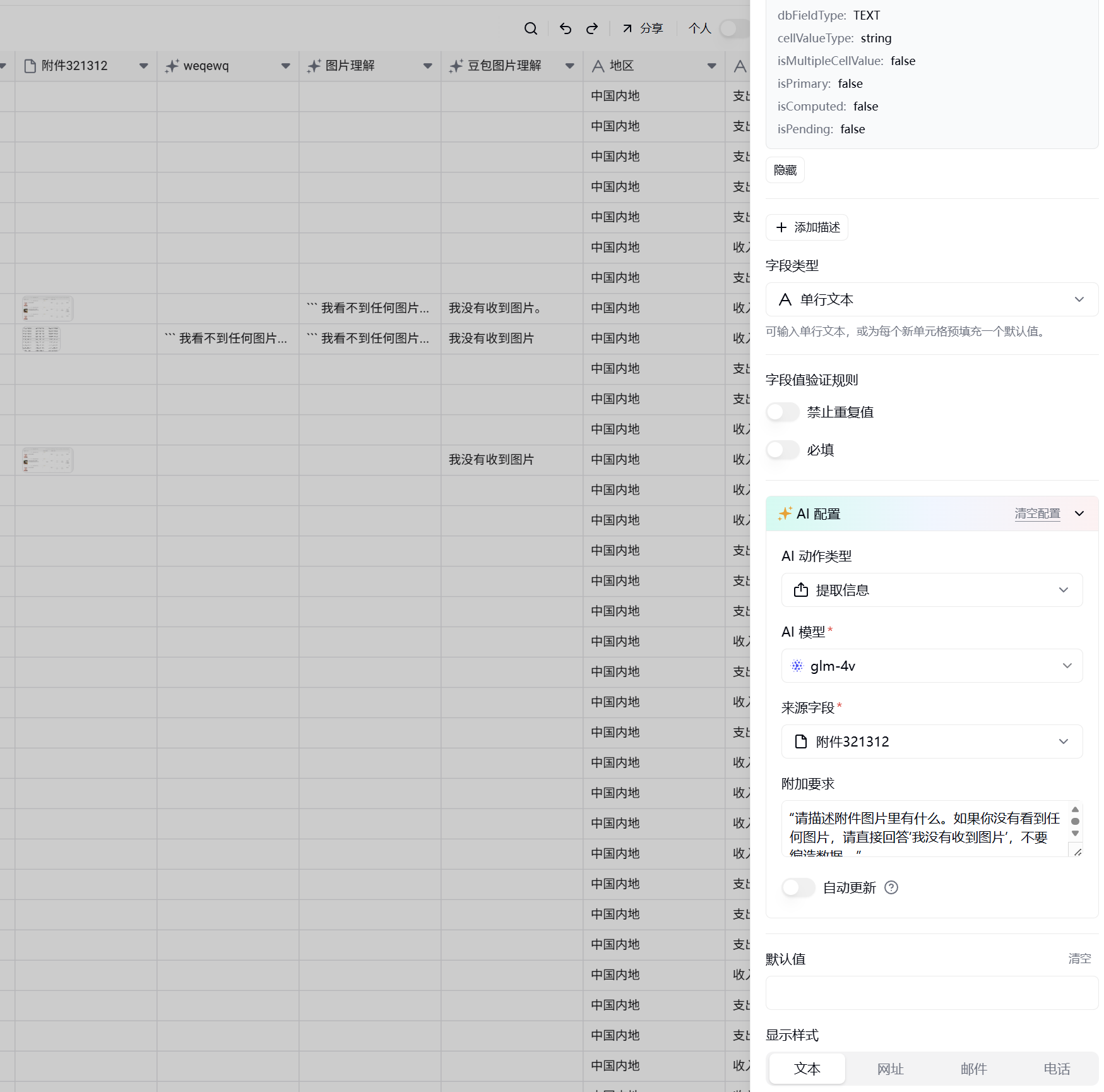

when I use qwen3.5:9b also cant use the ai agent, the allow list include this model

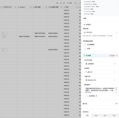

also i want to ask , why i am using image model, but he cant read the photo

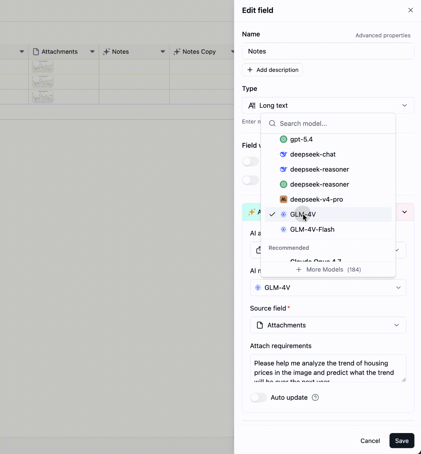

Hi @aa340271330 ,
The models listed are those you’ve configured in your space — not all of them support AI Chat Agent.

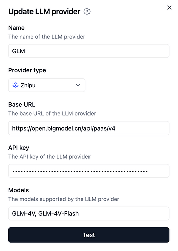

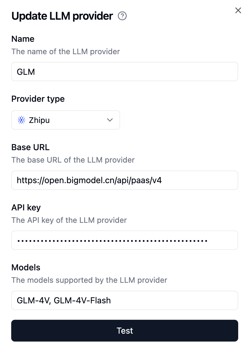

I tested with a same model on my end and it worked fine. Could you share your BYOK configuration details? Specifically: which provider and endpoint are you using? That’ll help me figure out where the issue is.
20260430015639_rec_
Here is my GLM BYOK settings.
