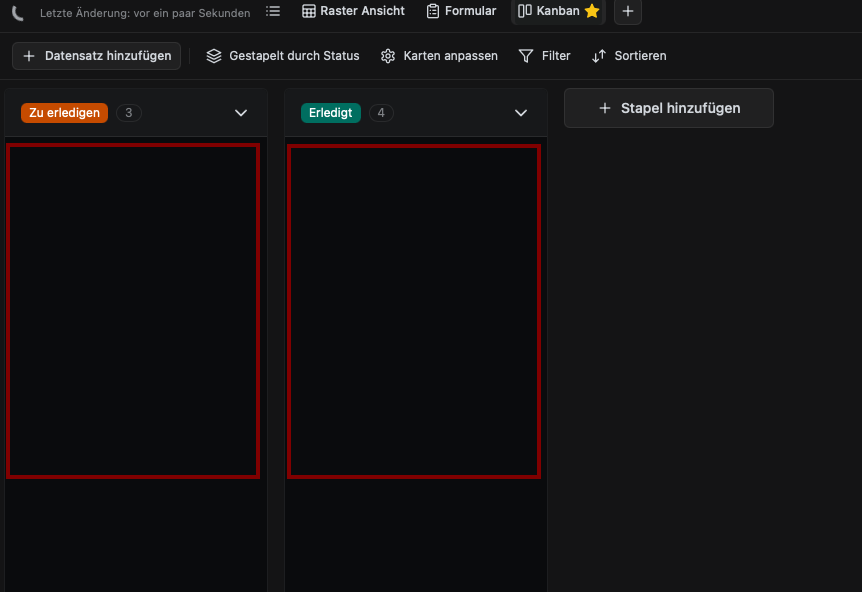

Now I can open teable but the table content is not loading. In my Docker log, I see many 404 errors
teable-1        | {"level":30,"time":1768126272664,"pid":88,"hostname":"287f790ddcb6","name":"teable","req":{"id":"96f2bf75a8d9f587212f303ece7ab48f","method":"GET","url":"/socket","query":{},"params":{"0":"socket"},"remoteAddress":"::ffff:192.168.0.1","remotePort":50350},"trace_id":"96f2bf75a8d9f587212f303ece7ab48f","span_id":"d18fbe2cfd80dbca","trace_flags":"00","res":{"statusCode":404},"responseTime":2,"route":"/*","is_access_token":false,"spanId":"d18fbe2cfd80dbca","traceId":"96f2bf75a8d9f587212f303ece7ab48f","msg":"request completed"}
And here is a picture of not loading the rows
How I can configure teable or my nginx proxy properly to get it working?

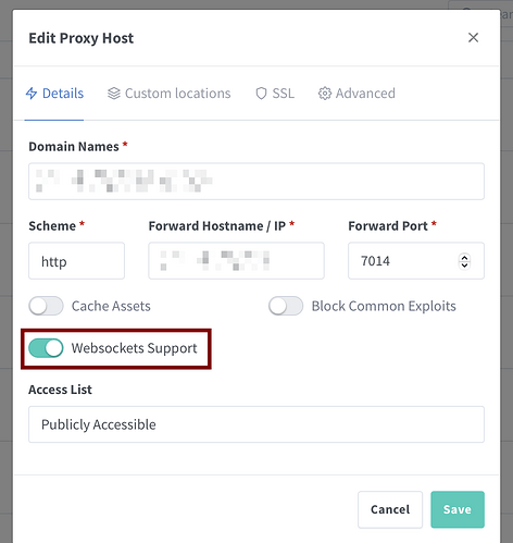

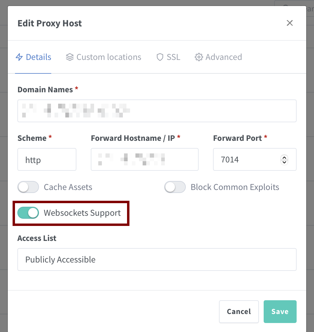

The solution was to activate web socket support in nginx proxymanager

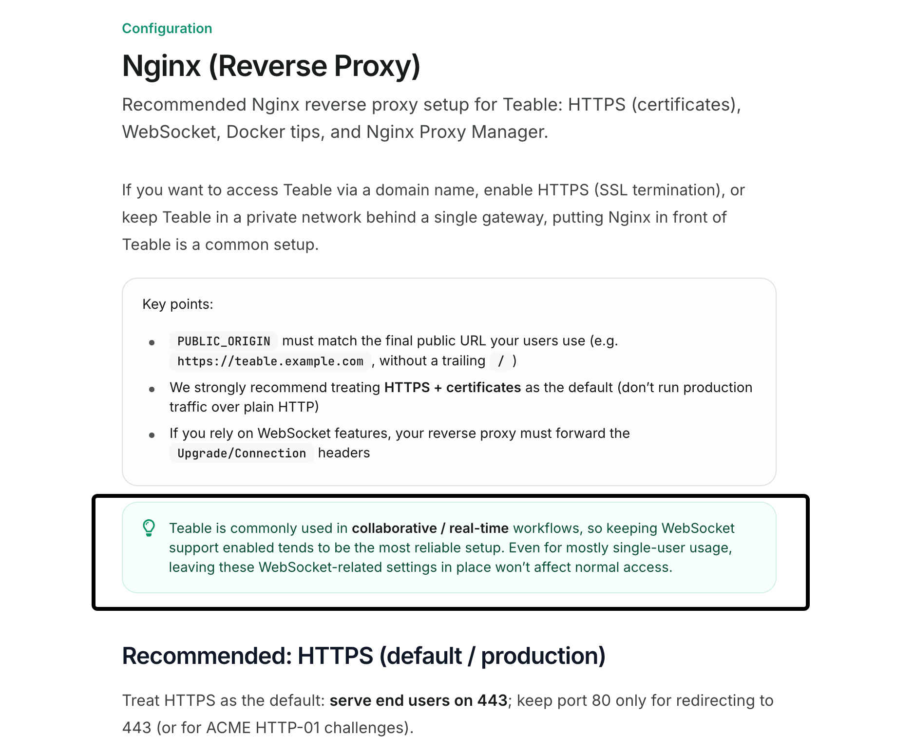

Thank you for the add-on. We’ve also updated it as a tip to make it clearer. @info1
