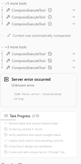

When I scrape with APIFY connector for X/Twitter posts, it shows JSON parse error and restarts the chat contents every few seconds. Sometimes the agent asks me for some confirmation via a dialog but I can see it for a few milliseconds and can not click on that. Also sometimes there are some kind error showing “Minified React error #158” or something (I am not sure about the exact wording.) Please help me solve this issue.

- Apify JSON parsing errors: We’ll check the connector responses and how they’re parsed.
- Chat reloading and UI errors: We’re aware of this issue and are focusing on message stream resumption and replay. Our initial suspicion is that reconnecting replays previously received content from the beginning, causing flickering and rendering errors. We’ll also check recent related changes.

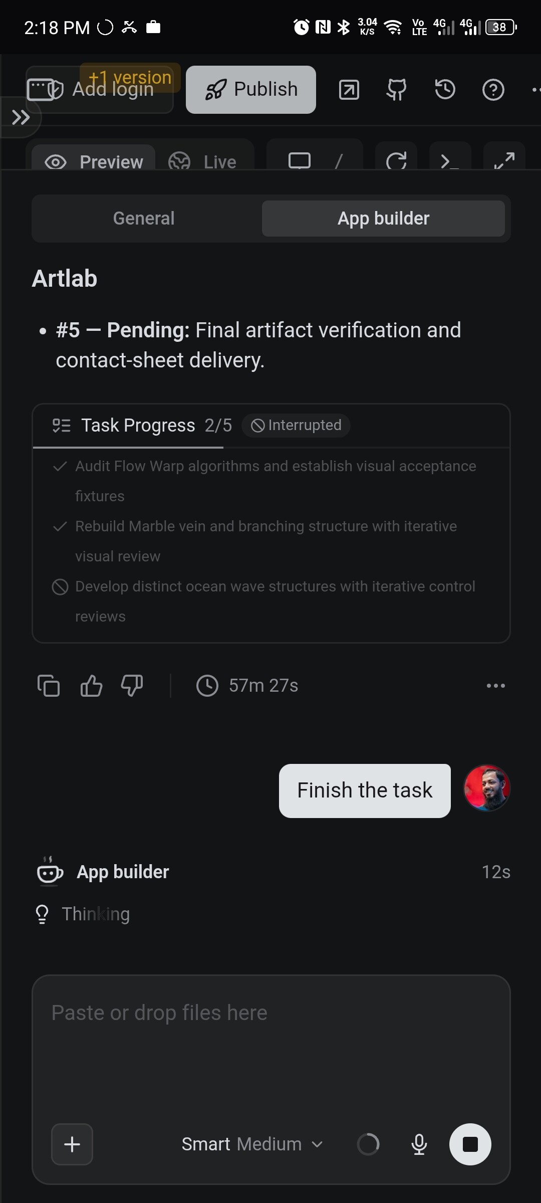

Now it shows “interrupted”. The agent can not finish half of tasks without reoeating “finish the task”.

Thanks for the update and screenshot. I’m sorry these interruptions have disrupted your progress and made you repeat some of the work. Here’s where things stand.

We’ve released fixes for:
- JSON parsing errors in chat.
- Chat content repeatedly reloading.
- Confirmation prompts disappearing before you could respond.

We’re also looking into the “Interrupted” status you reported and the need to manually continue. Our focus is on reducing interruptions and repeated work during recovery. We’ll share updates here as those improvements are validated.

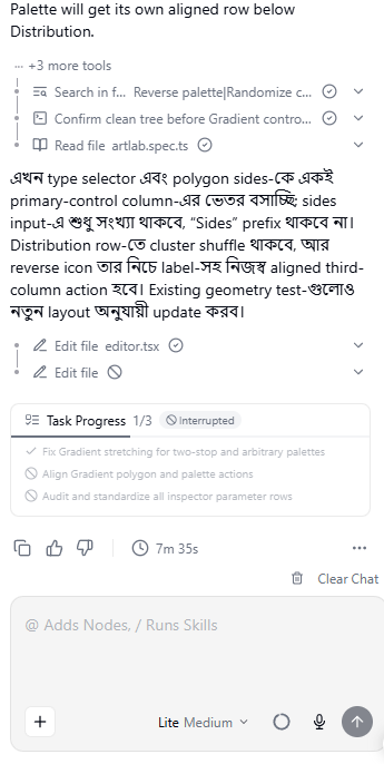

This is getting even more frustrating now. It now stops under 10 minutes too. I am thinking that is it happening to me only? Where are other Teable users, do you face this?
