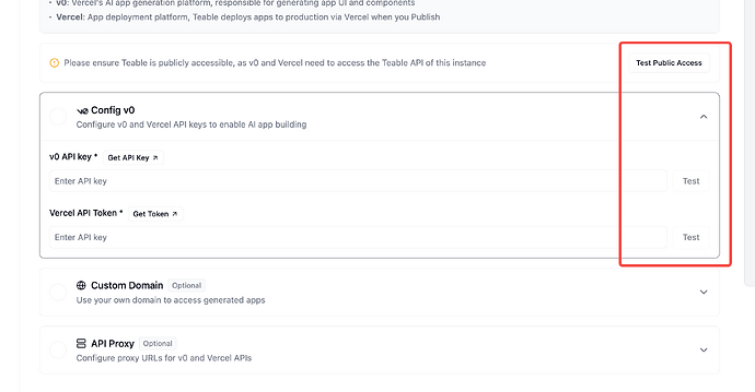

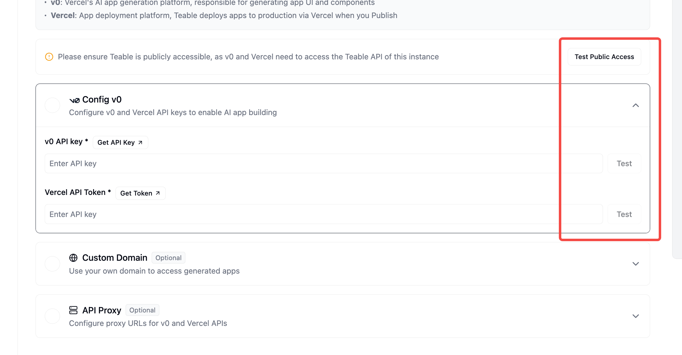

Hi Alin! To help us diagnose this, could you share:
  1. Test results on the App Builder settings page — click the Test buttons for “Test Public Access”, v0 API key, and Vercel API Token, and let us know which pass/fail
  2. Can you chat in the AI panel? — try clicking “Generate” on the left side of the App Builder and see if you can have a conversation there
  3. A screenshot of the error you’re seeing
Thanks!

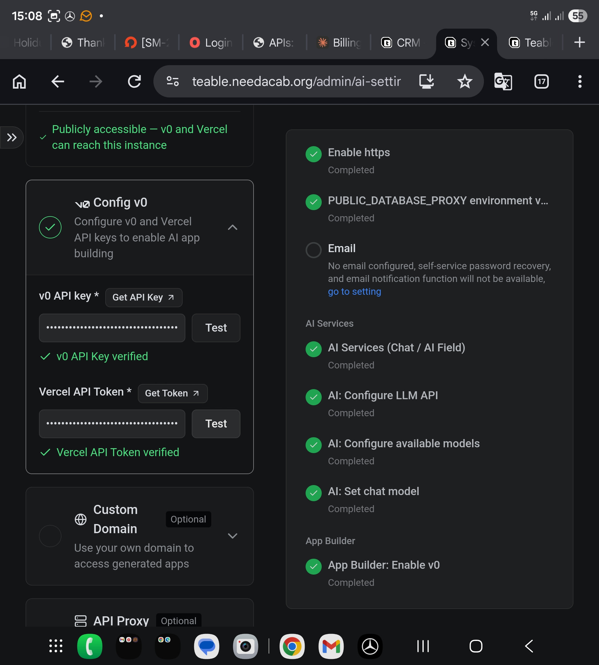

As yiu ca see is all green
